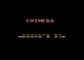

http://seban.pigwa.net/kacper/turbo_2k1_tape/loading_screens/chimera.png  http://seban.pigwa.net/kacper/turbo_2k1_tape/loading_screens/mirax_force.png

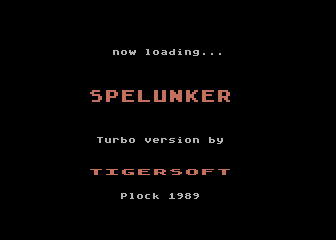

http://seban.pigwa.net/kacper/turbo_2k1_tape/loading_screens/spelunker.png  http://seban.pigwa.net/kacper/turbo_2k1_tape/loading_screens/spy_vs_spy_II.png
